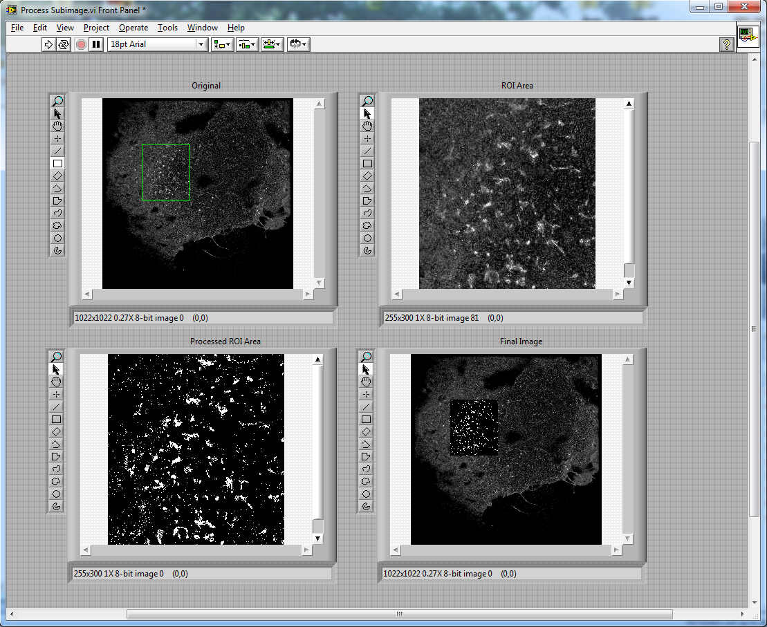

Image filters inside an ROI
Does anyone know of a way to apply image filters (edge detection, threshold…) to only the portion of an image inside an ROI?
Thanks for any advice,
Brian
Dear brian,
 I dont know its a good idea or not. Why cant you try image mask (Mask From ROI) function.

Take a look at the attached.  I think this is what you are looking for.  Make sure you have an ROI defined in the 'Original' image control before running.

Randall,
This is exactly what I was looking for. I modified your code to use video and it works great!
Thank you for your help.
