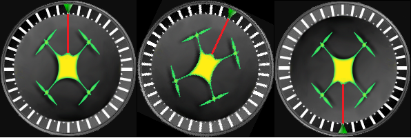

You Start out with a rectangular grid of pixels. For an arbitrary rotation, there cannot be a 1:1 relation between old and new pixels so some distortion is expected. What is your image type (greyscale, paletted, rgb, etc.).
You can make a fancier algorithm by e.g. adding some antialiasing or by using bilinear interpolation to get the new values.
Can you show us the "degraded" image?
Message 4 of 14
(8,595 Views)
Heres what they look like at 0degrees, 25degrees and 180degrees. There's some distortion when it's not at 0/180degrees.

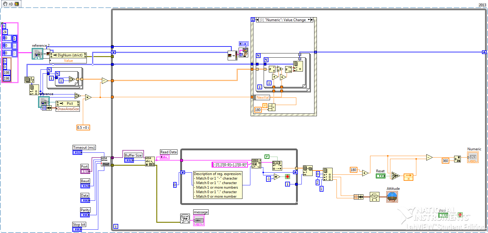

Also, I'm trying to change the control, instead of a slider, I want it to read data from a VISA serial port. However, I'm having problems. Data won't flow past the VISA configure into the while loop. Could you advice me?
Message 7 of 14
(8,533 Views)
Yuor main while loop will stall forever because you have an event structure waiting for a value change of an indicator. That will never happen. Value change events are for controls operated by the user. You need to eliminate the event structure and simple wire the rotation code to the received value. Why use a shift register for the image? Just place the indicator after the inner for loop. Learn about dataflow!
(I was only looking at the snippet, not the actual code. Maybe tomorrow.)
Please attach the actual VI instead of a snippet, because things get a bit messed up, especially with the property nodes. A lot of your code looks weird and convoluted. How does a typical received string look like? Does the lower code alone communicate correctly with the instrument if you leave out the rotation code?
