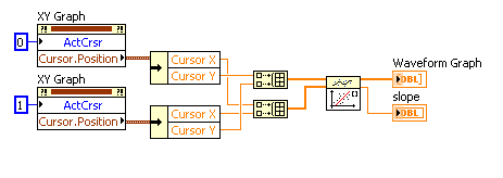

Hello phanikiran,
It's just building an array of the two elements and simply connect them.

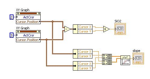

Let me help you a bit.
The two property nodes you use for the slope are excessive you can simply use the ones you already use for SiO2 indicator

Hi Koen,
Thanks a lot, I have done the same thing.

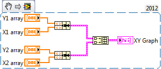

First, get rid of the Express XYGraph subVIs and use the "real" XY graph VIs. The Express ones get you going faster for simple things, but your options are limited.
Take your X and Y arrays for both your original points and the best fit points (just two points, right?) and combine them into clusters of arrays (instead of feeding them into the XY graph). Then combine these into an array and feed it into your graph. It's all outlined in the XY Graph section of the LabVIEW help file.

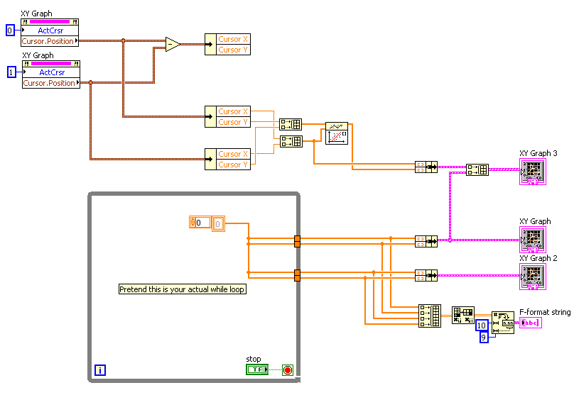

Hi Phani,
Saw you contacted me so here is the solution.
Actually Cameron already mentioned the solution above.
Anyway this it what it should look like when you implement it:
Note: The while loop is just a pretention the output aren't in correct order.
