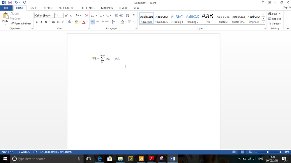

Can someone help me out with the implementation of time delayed features in labview? I am attaching a word file with the formulaeScreenshot (41).png

Hi theres,
I don't see any "time delays" in those formulas.
They are just simple sums with array elements…

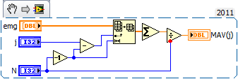

Accepted by topic author theres
Hi theres,
this should resemble the first formula:
Edit: you should wire "N" directly to the length input of ArraySubset…

Thank you so much GerdW KNIGHT OF NI for that demonstration. It is surely of great help to meSmiley Tongue

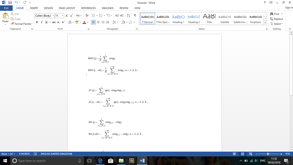

I am working on the extraction of time domain features from EMG signals. I have attempted the program with the understanding of the existing formula but am not getting the desired result. Also I have n idea as to how to set the threshold for the same. I am hereby attaching the program along with the formula

Hi theres,
why do you start a new thread for the very same problem?
You really should do the LabVIEW basics and learn to handle arrays within LabVIEW!
This is the equivalent to your Word formula:
Subtract X[i] from X[i+1], take the absolute value, sum all differences…
Why do you think you need to AND some float values, compare the result to a threshold  and sum up boolean values?
(There still is no "time domain" in your formulas. Nothing related to something like "t", "dt" or similar!)
