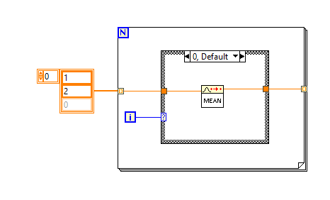

I'm not sure I understand your question, are you wanting to use Mean Pt by Pt on several different pieces of data, which you don't know the number of until later?
I do not know a way to do this, but I have put Mean Pt by Pt in a case structure (one instance in each case) which is just selected by the iteration terminal of the loop. This makes it a little more compact on your diagram.

Yes I would like to use the Mean ptbypt on several pieces of data. We know the number of data for a given application but it may be different for a other application.
I am not sure I follow your suggested implementation.
