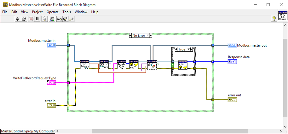

The point is that the problematic VI is this write request:

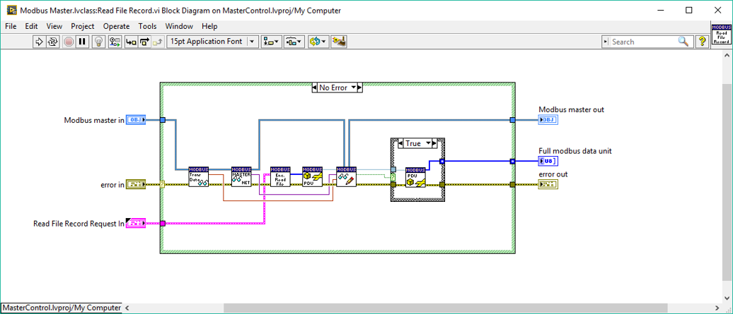

while this read request (structurally identical to the write) works perfectly:
All the VI seems in the right place (members of the Modbus Master class), no errors are reported by the IDE during opening of the project (the error is runtime) and I can open the files from the souce browser under the Modbus Master.lvclass.
I have no idea of how to solve this problem. I hope somebody has a clue of what is going on.
