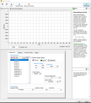

It would be helpful if you could share your code.
What happens if you take the 9211 out of the picture?  That device can only sample at a max rate of 14 S/s.  If you are recording data on 4 channels, that's about 300ms.  If you have this DAQ assistant in the same loop as your analog inputs, everything will slow down to this rate.

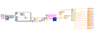

I share below the code I currently have developed, as well as the channels I have configured at the moment. I really appreciate your suggestions or observations to optimize the response speed of the system and improve the overall performance of the application.

@cristianCR77 wrote:
Where's the rest of the program?
There is no top-level loop (are you using "continuous run" mode???)
We see a local variable but the terminal is nowhere to be seen.
All rows have the same size, no need to measure that over and over inside a tight loop.
We have no idea what's happening inside the blue SubVI.
How do you define and measure "response speed"?

Hi cristian,
I share below the code I currently have developed,…
I really appreciate your suggestions or observations…
There's a difference between "code" and "image of parts of code" - we cannot edit/debug/run images with LabVIEW.
When you need help then YOU need to provide (real) code and explain the whole picture!
