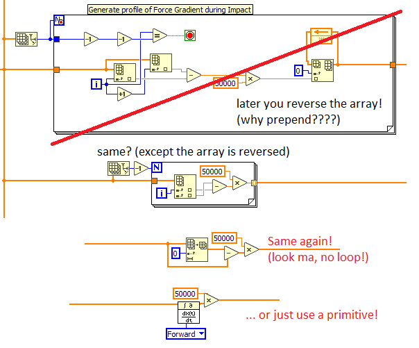

Your VI has massive problems that have nothing to do with  FOR loop efficiency.
  • We are missing a subVI
  • Your Feedback node is globally initialized and with this retain all data from all iterations (Main problem!)
  • Prepending data to an existing array causes massive memory allocation issues.
  • Delete from array is not the right function to take a subset.
  • Index array is resizable
  • You don't need the conditional terminal because the number of iterations is known before the loop starts (inner FOR loops).
  • There is no need for any dynamic data anywhere.
  • What is the point of rattling through all data if no record is kept?
  • Please do no maximize the diagram and front panel to the screen.
  • Why do you say subVI? This looks like a "one shot downhill toplevel" with no connectors defined.
  • Don't put indicators inside tight inner loops.
  • I have the feeling that done correctly, your code would fit on a postcard!
  • etc.
Please attach your missing subVI and a set of typical files.
(772 Views)
Just compare your code and some better alternatives: (This is just the tip of the iceberg!)
(Yes, there are even no-loop solutions!)
(766 Views)

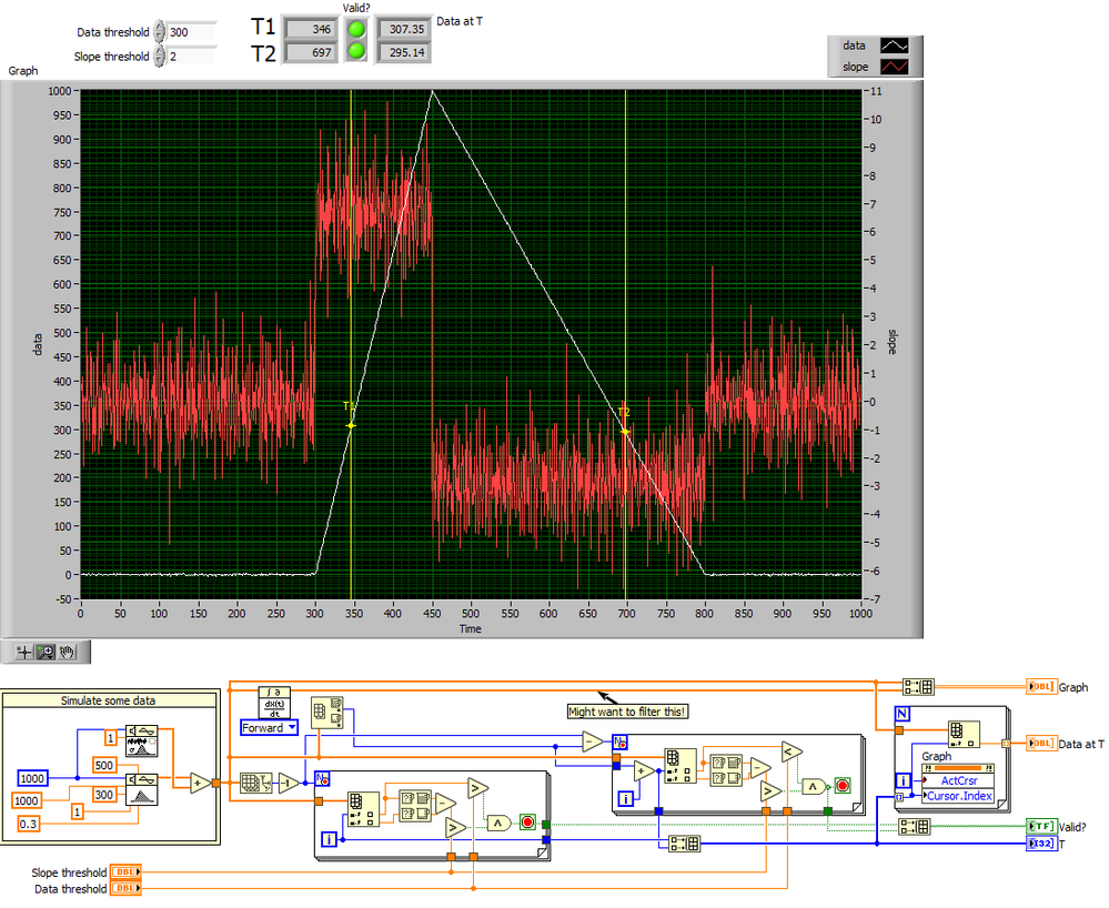

@altenbach wrote:
OK, so you need to find two positions:
  • The first point (T1) where data is>30 AND gradient >10k
  • The second (T2) where data is<30 AND gradient >10k
Your files have no timing information, so I assume you just want the array index of these two position.
Here's a very quick generic draft to do this. Most likely it would need some tweaks, for example the second loop could start with the array max position.
Of course you need to adjust the thresholds and potential filtering of the derivative according to your needs. You also need some exception handling.
Of course you don't need the cursors and graphs.
The code could be further simplified by placing the two FOR loops in a 2 iteration FOR loop and adjust the code accordingly.
(727 Views)
Here's how that could look like:
