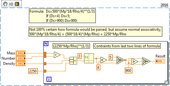

I agree with saying that (a) you should post code (the simplest way is to attach your VI, not a picture, certainly not PowerPoint), and (b) you should not use Formula Nodes if you want speed.  I'll wager a dime this code will beat yours many times over.
[This, incidentally, is a LabVIEW Snippet, a .PNG "picture" that will turn into executable LabVIEW code, due to some NI "Magic", if you drop it in a LabVIEW 2016 (version shown in the upper-right corner) Block Diagram.]
