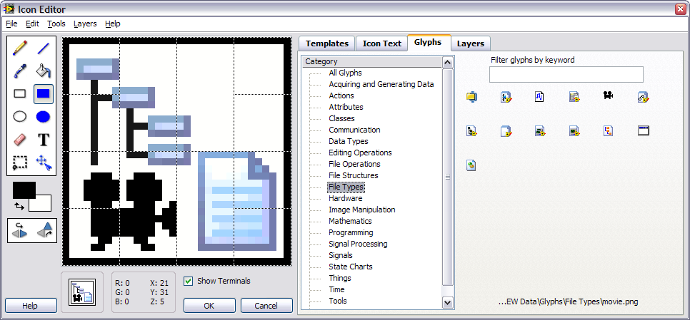

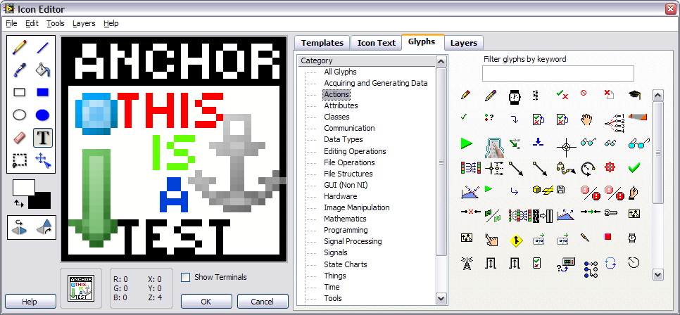

If anyone is interested; I made some cosmetic "improvements" to the LV 2009 icon editor.
See here for more info.

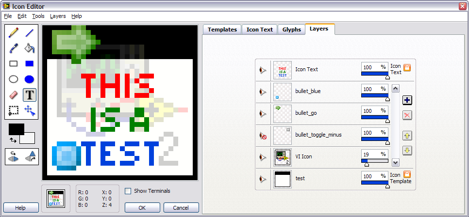

Version 1.4 has been released:
Change Log:
Version 1.4:
  • [Cosmetic Change] Major redesign of the layer control visual aspect.
  • [Bug Fix] The text marker (^) is hidden behind other objects.
  • [Bug Fix] CAR 182992 File save (template or glyph) failed if the hierarchy has folder with a dot in its name.
  • [Bug Fix] Flush glyph filter when changing glyph category.
  • [New Feature] Glyph filter works only on the visible category and does not reset the category to all anymore.
vipm.io | jki.net
Message 4 of 10

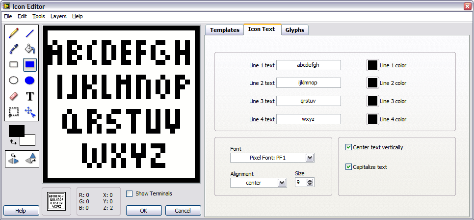

Version 1.7:
  • [New Feature] Add a condensed pixel font that allow for longer text to be entered.
  • [Bug Fix] Synchronize the "Edit>>Show Terminal" menu with the "Show Terminal" check box.
  • [Bug Fix] CAR 186982: "[IE] Wrong Icon is loaded in Icon Editor".
Get if here.
