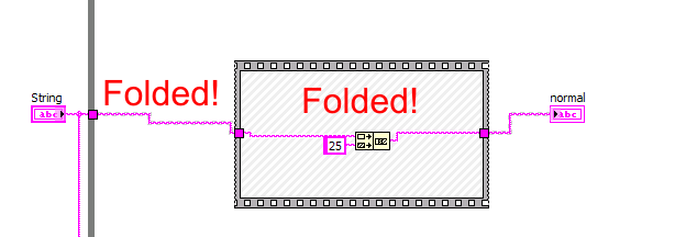

  6. Since your sequence frame deals entirely with constant values, it is folded into a constant and no longer processed at runtime. That's why it is faster. It does no do anything! Place the control terminals inside the loop and convert the diagram constants to controls for a fair comparison. You should enable the display of cconstant folding to be more aware of these things (see picture below). Actually, both loops are folded, so you are basically measuring the speeed fo reading the stop boolean terminal and updating the loop counts. Not very interesting!
