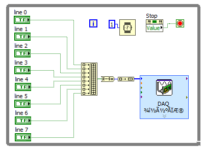

I can see many issues that could impact performance and are even dangerous.
  • Why do you need to hammer the DO 1000x per second even if none of the inputs have changed?
  • Values properties (e.g. "stop") are much more demanding because they require a thread switch and synchronous execution. Use local variables instead.

For the 1ms, I was talking about the small independent loop that just takes the 8 Boolean controls and sends their value to external hardware. There is no reason to spin this faster that the user can possibly operate these switches (use an event structure!). The output only needs to update when one of the switches changes and not hammered 1000x per second.
You obviously are thrashing the memory. To lower the load on the memory, maybe all you need to chart the last 1k points and directly stream the data to a binary file for post analysis.

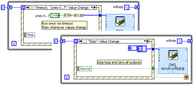

@altenbach wrote:
...(use an event structure!).
Here's how that could look like:
Message 7 of 13
(2,818 Views)

@altenhach
I understand what you're saying. The DO loop doesn't need to be updated every 1ms, so using an event structure as you suggested to reduce the load would be helpful.
