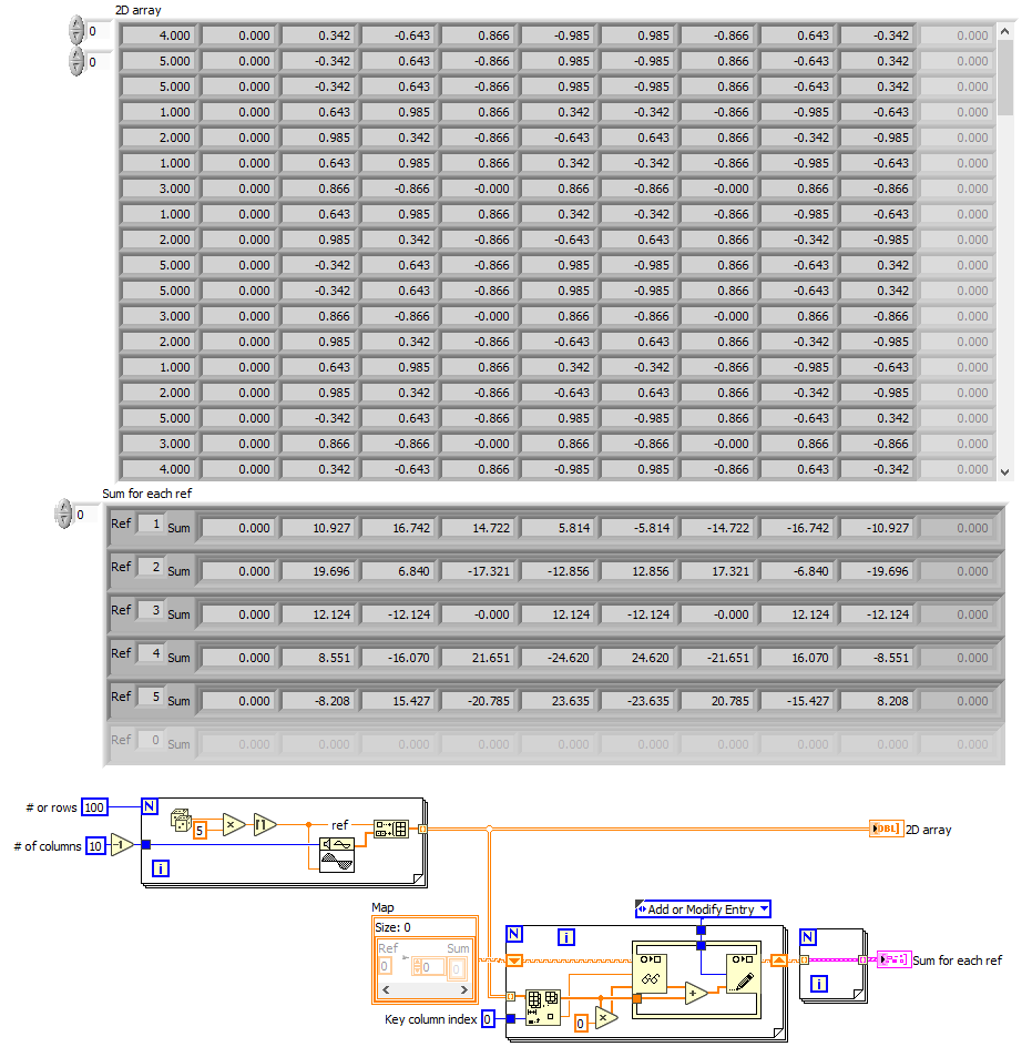

Here's a solution based on maps (LabVIEW 2019 only!).

Also note that the map solution is most universal, because we don't need to know the values and number of possibilities for the key column.

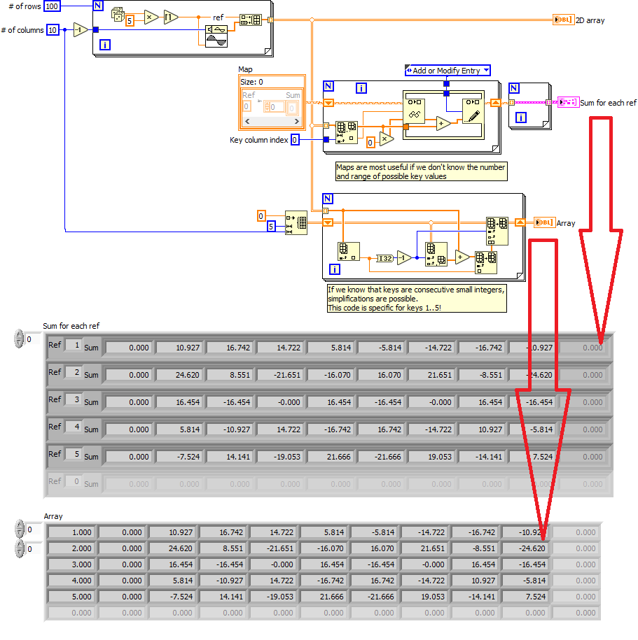

If we know that the unique keys are consecutive small integer as in your case (?), things can be further simplified and maps are not really needed (bottom code).
