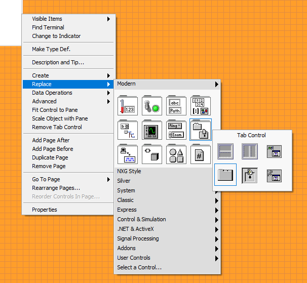

According to my tests, doing a "right-click ... replace" with a modern tab control leaves all tab contents intact. Try it! Make sure you right-click on the border of the tab control).

Thanks for the quick response. I suspected it was something simple but never understood this about the System palette. I'll replace the tab control.
