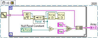

What you are doing works, but if you want something slightly more elegant you can check whether the front panel refnum is valid by comparing it to a default panel ref constant.
See the attached project zip.
A just has one button that calls B.
B just launches C as a modal dialog with one button and a table showing the call chain.
C calls D to populate the call chain table and waits for the button to be pushed.

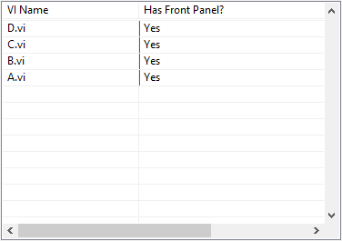

In the development environment, you should see:

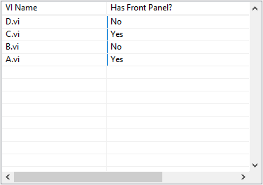

If you execute the build spec and run the exe, you should see:
D.vi.

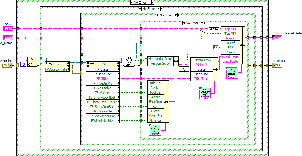

Here is a screenshot of what's working for me now (the various error cases include custom error handling). Here I just need to first try a FP access using a property (like CustomTitle) that will test the existence of the FP and if the FP is available, go on to get more properties of the FP. If the FP does not exist then the error is discarded, the VI reference is closed and the data cluster updated to indicate that the VI does not have a FP.
Thank you again!
