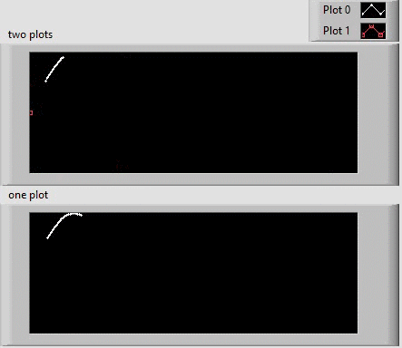

This looks similar to an issue I ran in to in 2013. It got a CAR but is not fixed:
https://forums.ni.com/t5/LabVIEW/Chart-Redraw-Issue-with-Multiple-Plots/m-p/2755616
It looks like this:
chart redraw issue with multiple plots1.gifchart redraw issue with multiple plots1.gif
As you can see on the bottom chart, the white sine plot is updated in chunks. The red single point plot is updated less often. When both plots are plotted, the white plot updates only when the red plot has a new point, but only parts of the plot is drawn.
At that time, I wanted to use the superior performance of the chart, but had to abandon it due to these kinds of issues. When I asked NI in 2014 about these, they hinted about what later became NXG, which would save us all...
Certified LabVIEW Architect
Message 4 of 13
(5,422 Views)
