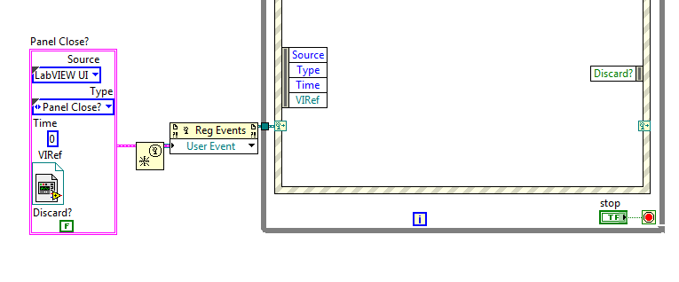

I'm curious now.  I was going to create a user event and add it to the same event case as the Panel: Close filter.  I get an error that says "Filter events must have identical data to share a case."  So I am trying to create a user event with identical data so that maybe they can share a case.  Anyone know if this is possible or is there a way to find out the exact event data?  I can see that there are 5 different values (4 input, 1 output) but this isn't working.  They may not be in the right order.

If all you are doing in the Panel Close? filter event is discard the event, then I don't see a really good reason to try to get a filter event and a dynamic event to work in a single case.  I don't think they would work together anyways.  So just make another event case that does the same thing as the filter event using a User Event.
