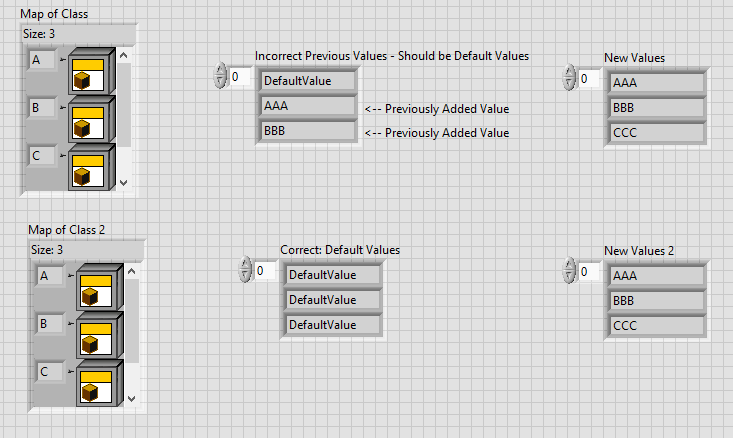

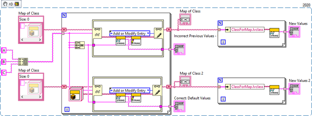

When I use the In-place Map Get/Replace node to insert entries into a map (if they don't already exist), the data returned is the previously added value, and not the class's default value, unless the class constant is wired to the node as the default value. I do not expect this behaviour.  I have attached a simple example.
WrongClassData%20Snippet
Front Panel showing the Previous Values instead of Default ValuesFront Panel showing the Previous Values instead of Default Values

Does it help if you wire the "default value" of the left IPE node?
It seems like the returned value is undefined if the default value isn't wired. Can't find a reference though.
Why wouldn't you wire the "default value" of the left IPE node?
(2,377 Views)
Yes wiring the left node avoids the issue.
Why wouldn’t I wire it? Laziness. But in my defence, it doesn’t behave this way with simple data types and there is no explicit documentation of this behaviour.
I think it at least warrants some more detailed documentation, but honestly I think it is a bug (even if it is sloppy programming).
(2,366 Views)
IIRC, there is an idea that the default value should be required. It might have evaluated to a BUG already. Can't find it...
I could be mixing things up with The-key-input-of-the-IPE-s-Map-Get-Replace-Value-node-should-be or a thread somewhere else... EDIT: I put a comment there, maybe the can address the issues in one go.
I'm not sure what I prefer, having to wire it or getting undefined values. I don't have much map milage.
