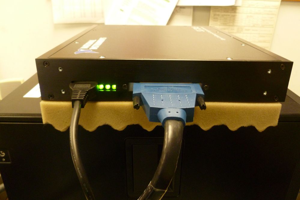

Tell me this may be the problem.  The software now runs but there is no communication to the data acquisition front end.  I had a similar problem when computer manufacturers starting cutting back on the voltage outputs to save money on power supplies.  The last system I put together before retiring had it's own power supply (picture attached).  The system I am having problems with never had a power supple and was on a very old computer running XP.  Could it need a power supply?

This is very frustrating.  Is there anyone at NI that knows how to 'integrate' a system???!!!  I grant it that my hardware is not that new, but a simple question concerning how to ascertain if the front end is communicating with the computer should be an easy thing.  I used to run into this type of situation all the time when asked to troubleshoot an electric motor being driven by a variable speed drive.  There were people that would test the motor by itself and bless it as good.  There were people that would bless the drive and bless it as good.  There is usually NO ONE that knows how to look at both of them as a system and solve the problem  For example, a back feedback signal or tach would drive the system crazy with very high vibration levels, yet it was overlooked frequently.
My problem.  I have time tested code.  It requires the RunTime Engine and the DAQmx drivers for a PCI 6221 data acquisition board.  The front end is a 12 year old M series 2345 front end with ACC modules and one Analog module for a tach input.  This is difficult stuff people, and I really appreciate the help from the forum.  You folks are head and shoulders above NI tech support.
My end user called and they looked up my license and said it expired in 2015!!!  First of all, didn't know they 'expire' and second of all, that's the year I bought  it to transfer the vi's to Windows 7!!!!!!
So, anyone that can answer my question about needing to power the front end with a separate power supply or not would be greatly appreciated.
Ron
