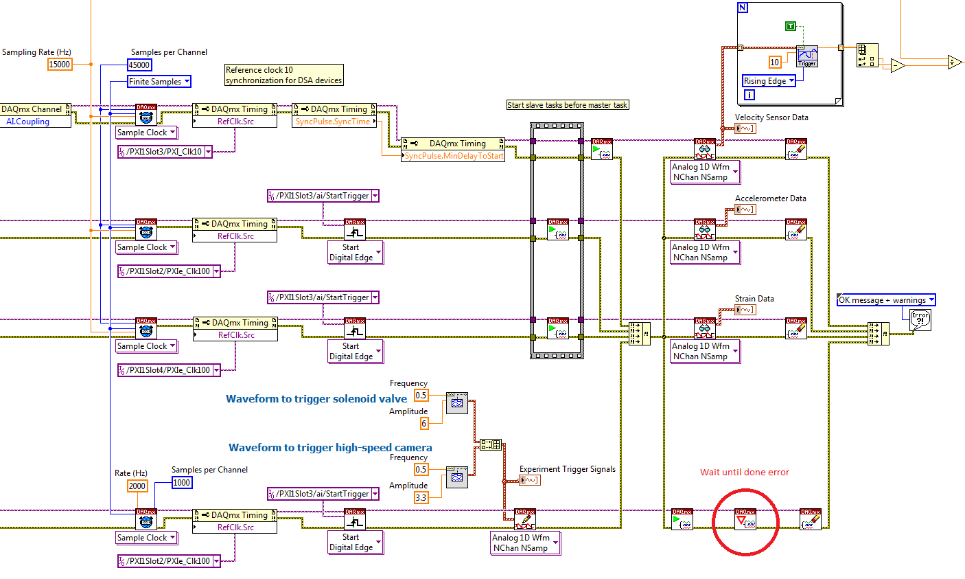

Sorry, I should have explained better. The "ExperimentDAQ.vi" program already includes the other program incorporated in it. This is my actual vi where I am generating the error. The "AO_Triggers_LowLevel.vi" is only included to show the working program that I need to incorporate into my full program.
The image below shows where my error is occuring in my actual vi.

I believe I fixed this issue. I extended my Flat Sequence structure to include the task and error lines of my analog output task and things seem to be working.  I am still unsure as to what caused my error and why this solved the issue...

You need to start your AO task before the AI Task that is sending the trigger when it starts.  Originally, you had your AO task starting after the AI tasks and it therefore never saw the start trigger.
So you should move the Start Task for the AO to be inside of the sequence structure, not after it.
