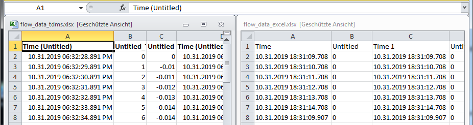

Query 1: When I added the write to measurement file the total number of samples of the recorded data was correct. I tried saving the data in both excel and TDMS in write to measurement file. However, the timestamps go haywire, but the data obtained seems to be correct as it corresponds to the plots presented in the chart. The sampling rate is 100Hz.  Could anyone help me to fix this problem? How to get a proper time stamp?

If you look at the timestamps of the data, the seconds and milliseconds are not following a proper order. The milliseconds difference is grouped together for each seconds as indicated in the uploaded caption (row 8-26) and (row 27-58; row 59-84 and etc.) in the uploaded excel file.
In TDMS file the millisecond differences of each second were presented in multiple sheets. However, the data was correct when it was plotted on a graph.
When I rearrange the timestamp according to seconds and milliseconds, the nature of data is changed.
Thanks.
