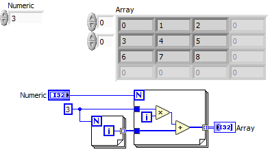

There are many possibilities. For example you could do a 1D array three times longer, then reshape to three columns.
Another possibility is for example this:
(2,792 Views)
Thanks for helping me, my problem has been solved.
(2,739 Views)
Note also that my solution is what we call "scalable", meaning that very little change is needed to get a different number of columns, e.g. 0,1,2,3|4,5,6,7|8,... etc. The "3" diagram constant could even be made into a control and the entire code turned into a subVI with two inputs (# of rows, # of columns) and one output (2D array).
