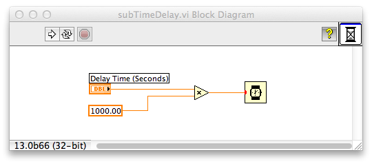

1. If you open the front panel of the Time Delay Express VI and look at the block diagrams insde your find this:
The resolution of the Wait (ms) function is 1 millisecond. So you cannot get any specified delays shorter than that.
