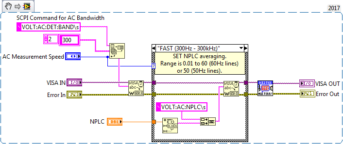

And try to make a better example for "Performance.vi" Example for AC voltage measurements like attached.
Test it and let me know if that works.  (I don't have 7700 card, only 7712s.)

Sorry for the delayed reply. I was able to work on the performance.vi
I agree to your answer. The bandwidth adjustment is added before we could set our measurement to lower NPLC or Aperture Timing.
I used "ConfigAC.vi" before "timing.vi" in "performance.vi" . I set the bandwidth to 30000 and the measurement is faster now.
Thanks for all your help.
