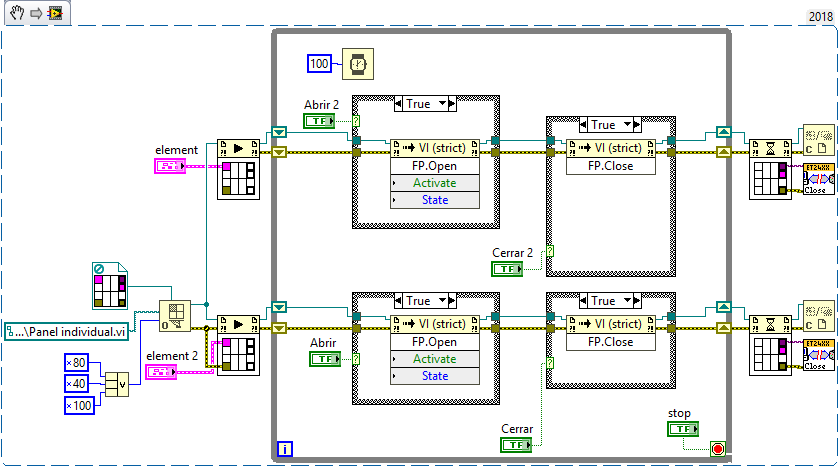

Hi, I am making a control panel for eight temperature controllers. The controllers communicate to labVIEW with serial communication. I made a subVI that has a while loop inside to display temperature values every certain time. In the main VI I call twice this subVI with independent parameters (inputs) and control the open/close of their front panels with buttons. Although, the Hierarchy diagram shows that both references points to the same subVI so I cannot open them independently. Can you help me, please?
Main VI:

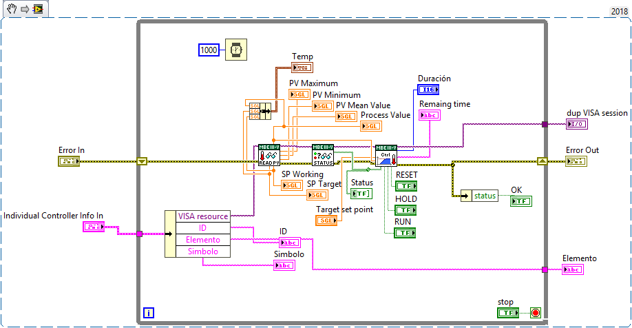

subVI Block diagram (Panel individual.vi):subVI bd.png

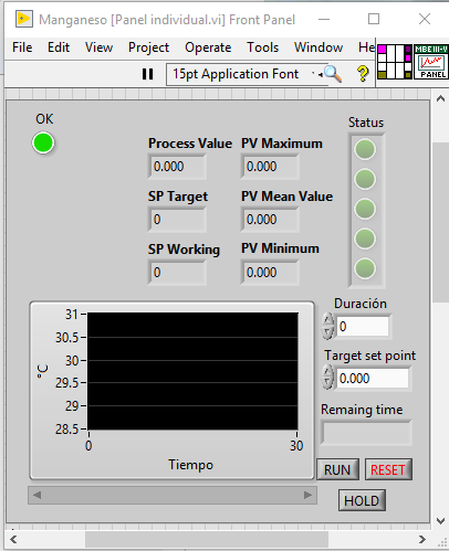

subVI Front Panel:subVI fp.png

I believe you need to call Open Reference twice to obtain two references.

Jhonny,
     It looks like you set the caller code up correctly to Start Asynchronous Call on a "clone".  So all you should need to do is to make sure that your "clone", Panel Individual, has its VI Properties set to Preallocated Reentrant.  I can't tell if you've done that by looking at your Snippet, which is why it is advisable to attach the actual VI(s).

Accepted by topic author Jhonnytisca

(3,615 Views)
I did it and I succesfully opened two independent front panels but a get another thing wrong. When I opened a front panel, it seems not to be working, it was just freezed and any of its buttons worked.
(3,578 Views)
I was using the "shared clone option" so I changed it to "preallocated" and it worked but now both front panels seems to be freezed and none of its buttons worked. I tried not to use asynchronous call but Run VI method instead and I think it is a solution for now
(3,574 Views)
