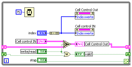

Hi John,
you can work with property nodes to set the index of the visible array element:
(The English name of that property should be "index values".)
Use a scalar numeric control and hide the index display of the arrays...
Your inner while loop was just RubeGoldberg...
