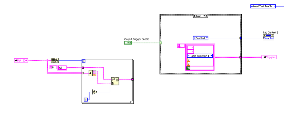

So I have created an array of clusters.
within the cluster are 2 comboboxes which I would like to initialise with a string array I have generated from 'plot_IO'. However I have no clue how proceed further to do that.
Would anybody be able to advise on how it, if it is at all possible.

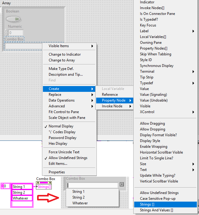

Find the control within the array on the front panel.  Right-click the border of the combo box and select "Create ► Property Node ► Strings []".
Drop that on your block diagram somewhere.  Right-click it and select "Change to Write".  Then wire in an array of your strings for the drop-down.Set combo box strings.png
