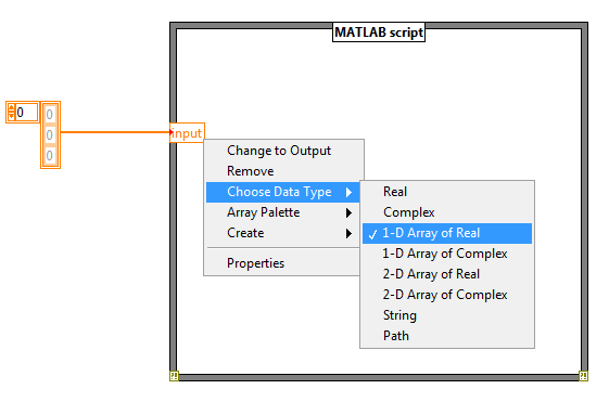

changshin,
you can change the data type of the input like this:
However, the node does not support arrays of single precision numbers. Instead, to eliminate coersion, you'll have to convert your input array of singles into a double array by using "To Double Precision Float" VI (Numeric > Conversion).
