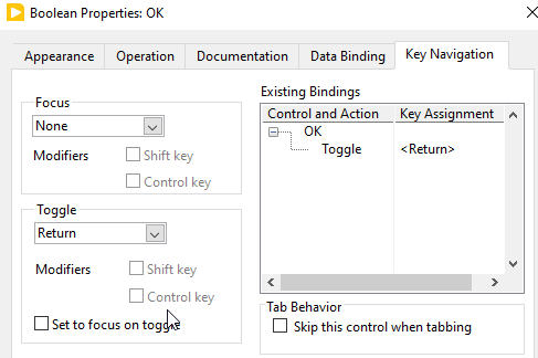

Was not an insane object. It was a feature I never used before or know how it got set.
In the properties for the boolean control the toggle was set to return, when the value was changed with a return key, the boolean "toggled" triggering an event. Still don't understand this feature.
If you place a new JKI state machine in a VI the <return> key is the default key assignment for 'OK' button.
