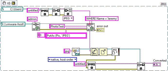

The Code below works just fine using this query
SELECT GetAs (Pic, 'JPEG') FROM PhotoTest WHERE Name ='Jeremy'
However I am having trouble attemping to update or insert JPEGs into the container. I am getting a Syntax error from the SQL Query.VI when I try to UPDATE a container field with a JPEG.   Using the code shown below, the SQL Query that is generating the syntax error is:
UPDATE PhotoTest SET PutAs (Pic, 'JPEG')=?  WHERE Name ='Jeremy'

My first hunch is that the UPDATE Query syntax is but perhaps the data of type "string" generated by the JPEG file string VI is at fault.  The ODBC guide for filemaker says that PutAs is for uploading a binary stream into a container.  In the parameterized SQL query the value is coming through as "string" rather than "binary", but changing the data type to binary before the Parameterized query was generated did not help.
 Should I typecast the string before using PutAs()?
So I am a bit stuck.   I realize this is as much a Filemaker issue as a LabVIEW issue, but if any LabVIEW folks have any insight it would be greatly appreciated.

I also noticed that you seem to have a space between the GetAs and PutAs and your field name/type. The examples I saw for FileMaker would make your SQL statements:
SELECT GetAs(Pic, 'JPEG') FROM PhotoTest WHERE Name ='Jeremy'
UPDATE PhotoTest SET PutAs(Pic, 'JPEG')=?  WHERE Name ='Jeremy'
Maybe the space is significant in the UPDATE use case...

The space after PutAs didn't affect the error.
