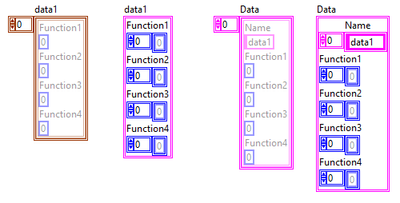

I think in some way, clusters are your answer here. Which way depends on a couple things:
If you're only queueing single bursts of data (four data points, one for each function) to your logging loop at a time, just a simple cluster would suffice as your queued data:
Spoiler
If one batch of queued data could possibly consist of multiple data points from each function, something a bit more complex might suit you, I'd also ask whether your data is always 1:1:1:1, aka do all your functions give data at exactly the same rate:
Spoiler
Sorry to give you so many options, but there's dozens of ways to group data and dozens of corresponding ways to parse it on the other end. Choose the easiest, most convenient one that you are comfortable using.

Thank you very much for the detailed answer. I accepted MrMattPayne's answer as the solution as it is the exact solution I was initially looking for. However, your description of how clusters could be applied show that this would be a better solution overall for how I am hoping to pack and unpack the data (each hardware function would have just a single data point for this format). Thanks for the help!
