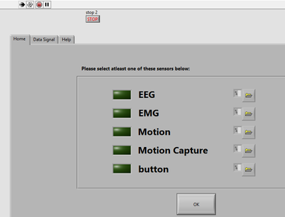

As shown above,
  • how to disable the OK button when none of boolean button is clicked and enable the OK button when atleast one of the boolean button is clicked?
  • when OK button is clicked, how to link the recently inputted file path control (that contains lets say a CSV file) to a waveform chart in the next tab "Data Signal"

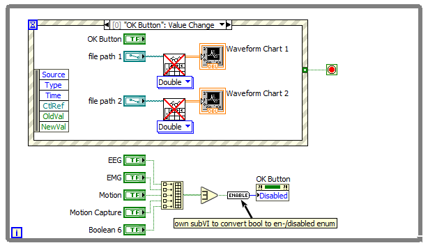

Hi H,
 You already know how to en-/disable the file path controls. You can do the same with your OK button: based on a condition you use the Dsiabled-property of this button!
You already did this in the event structure in your VI: use the filepath to read a spreadsheet file and display its content in a chart. What's your problem here?
On yur VI:
- NEVER delete lables of controls/indicators! You may HIDE them in the frontpanel, but NEVER DELETE them! How will you know, which property node belongs to which path control?
- Why did you use an additional loop to handle those disabled properties? Why didn't you create some value change events for your buttons?
- Why is there no value change event for your "stop 2" button?

Thanks for the response.
Have you even tried to run the vi I have given in this post? Have you also tried to understand my question?  The problem is it does not work as I wanted and thats the purpose of my questions here.
I know we can use the read a spreadsheet file vi but as mentioned, "how to link and display the recently inputted file path control (that contains lets say a CSV file) to a waveform chart in the next tab "Data Signal""
Noted, anyway I just double-click on the object to know which belong to which.

Hi H,
You asked for how to display the content of files choosen by the user in some charts - but you already know how to do that. What is it that you "want" exactly?
To link a data source (ReadSpreadsheetFile) and a data sink (chart) you should use a wire - as you already have done for your chart.
I still don't understand your problem - maybe you should explain it more detailed?
So when a colleague of you has to maintain your code (s)he always has to double click each item to learn about the relation of a property node and its control/indicator?
I guess you are not used to well-documented code…
As you seem to have problems with developing some simple algorithm I suggest some pseudocode:
IF all buttons == FALSE THEN /* build an array from your button values and use OR-Array */
  disable(OK button)
ELSE
  enable(OK button)
ENDIF

Hi H,
its only the file path control labels that I only HIDE.
No, wrong. You did not HIDE the labels, you deleted them (aka used an empty string as label).
I am always used to do text-based programming.
So you wrote code like '' = '' + '' using empty strings as labels of variables?
Beside this code documentation topic: did you read my answers above? Can you answer my questions?
Converted pseudocode from above:
