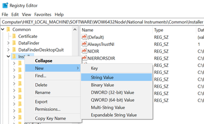

There is no explicit way to change the installation folder in the user interface of NI Package Manager (NIPM). In order to change it, registry edits are required. Follow the steps below to change the default installation directory of NI software before running your installations:
  1. Manually create the desired root directory for your NI software, i.e. D:\Bin\NI\
  2. Open Registry Editor. This can be done by using Windows search for "Run" and inputting "regedit" in the open prompt.
  3. Manually create the following registry keys and add a string value with the name and data included below:
    • (32-bit) HKEY_LOCAL_MACHINE\SOFTWARE\WOW6432Node\National Instruments\Common\Installer
      • NIDIR= <Installation Directory Path>
    • (64-bit) HKEY_LOCAL_MACHINE\SOFTWARE\National Instruments\Common\Installer
      • NIDIR64= <Installation Directory Path>
The 32-bit key will change the installation directory of 32-bit software and the 64-bit key will change the installation directory of 64-bit software. These two keys should generally not point to the same installation directory. These edits need to be made before installing the software for them to work.
Note: This process is not guaranteed to work for all NI Software.
