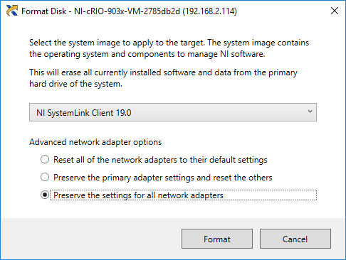

Install the SystemLink image
This is the way to make a cRIO fully SystemLink-ready. Right-click it in NI MAX and pick Format Disk (Note: This removes ALL data, configuration etc. from it!). A new dialog greets you:
