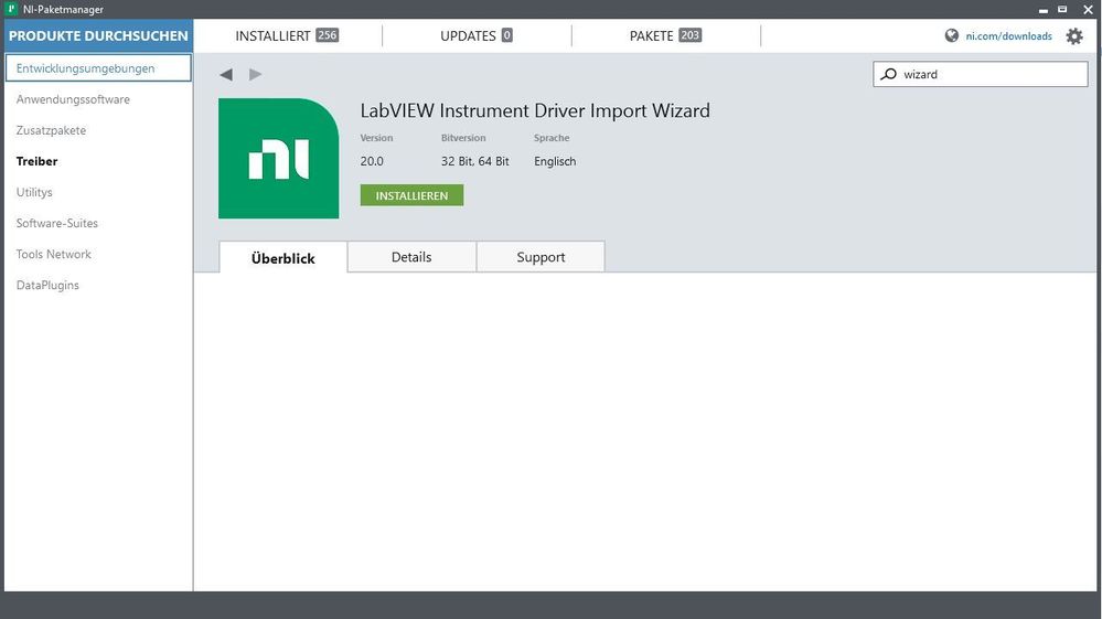

Hey together,
I just saw, that version 2020 is available via the NI Package manager
