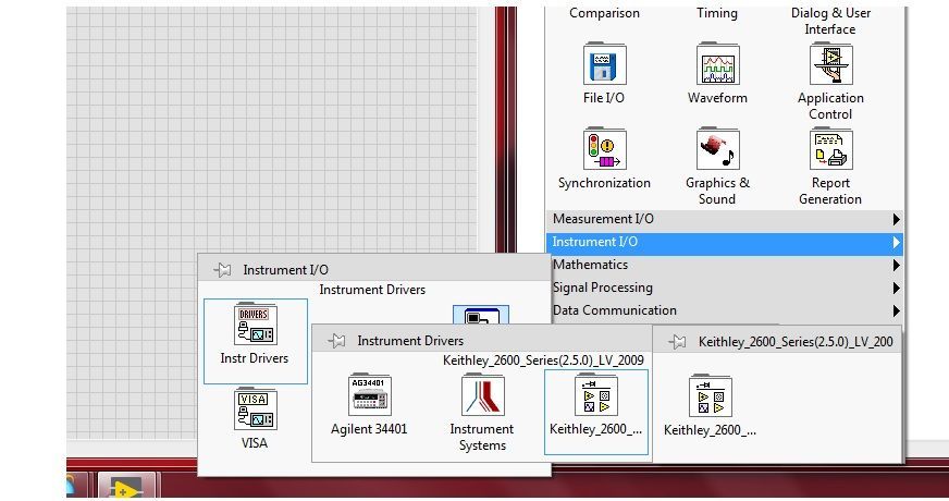

Here I have also added how it looks like in my LabVIEW. Keithley Driver.jpgKeithley Driver.jpg
here you can see there is Keithley 2600, but there is nothing inside. What to do?

Accepted by topic author govindsankar
zipped it to <LabVIEW>\Instr.lib\Keithley 2600\Keithley 2600\
One too many folders

Thank you, very much, too many folders were the problem. Got it now.
Sorry,
You unzipped it to a "New Folder" rather than straight into Instr.lib and got an extra folder.  just move the content of Keithley_2600\Keithley_2600\ to
instr.lib\Keithley_2600\

yes that is what i did
