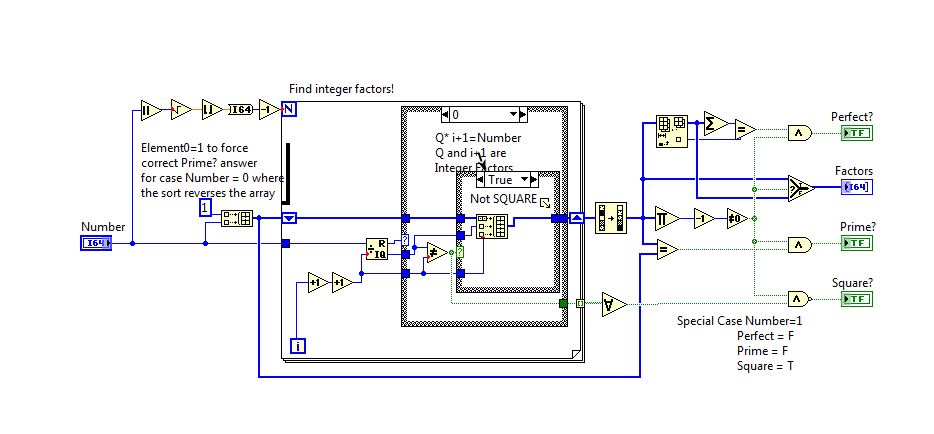

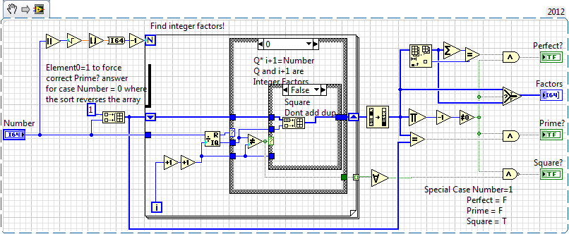

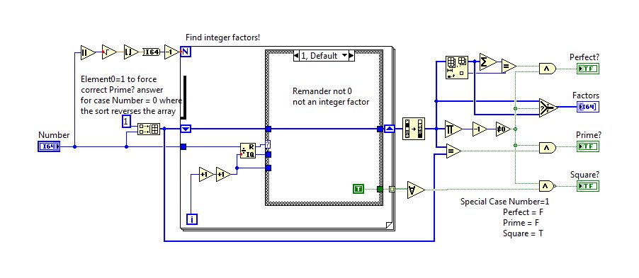

What is the 1, for the first case, and the false for the second case.
Message 16 of 18
(3,658 Views)
Hi HylerTeck,
Here are the screenshots of the two cases.
The example is a VI Snippet. VI Snippets, as a png file, can be saved to your computer and then dragged to an empty VI. A VI Snippet is a special png file that contains the LabVIEW code.
True Case:
"1" Case
Jordan G.
LabVIEW Product Marketing Engineer
Message 17 of 18
(3,621 Views)
1, Default  So the remainder of Number and "i"+2 is something other than zero. (So multiplying "I+2 by any number will not = number- it is not an integer factor - toss it out!)
2.   i+2 = Q  we don't need to duplicate the square factor.  e.g if Number is 25 and i is 3 Quotient and i+2 are both 5
(Wow that was a long time between bumps)
Message 18 of 18
