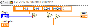

Look Ma! No loops!
(Of course this makes certain assumptions, such that the array always has 5 elements. Also SGL would probably be sufficient for 5 decimal digits. You might even do the array constant and summing in e.g. I32)
