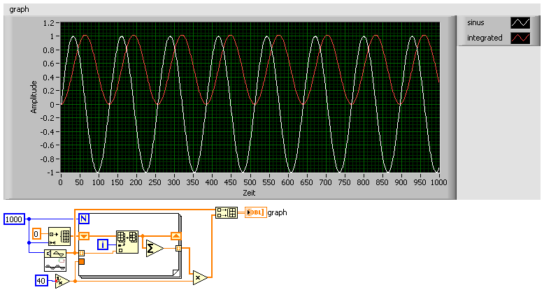

Hi Ali,
you may try this:

Many thanks, i will give it a go. would you be able to post the dot VI file please?

It's a snippet - and very easy to recode, so I didn't save it…

No worries, thank you so much

I have designed pretty much the same code as you have suggested, it sounds close, but unfortunately it didnt do it as expected. i am running with 4V peak to peak at 2 HZ using a sine wave as an acceleration signal.

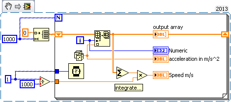

Hi Ali,
please attach a VI with data embedded (by making all values default)!

HI GerdW,
thanks for your reply. I have attached the code.
instead of the Input AI0 input, you could just use a sine wave of 10 Hz with any amplitude as long as you know what the integration would so you can compare.

Hi Ali,
what's wrong with the VI?
Everything as expected.
What else do you expect?

Hi Gerd,
Thanks for your patience. there absolutely is no problem with your code.
my problem is that i am reading continuously from a sensor and i want to perfrom the integral on the run continuously. unfortunately the way i am doing it according to the previous code that i have attached doesnt seem to do the integration properly. I tried to integrate a sine wave coming from an external generator with known attributes. unfortunately with the way the code is, it does perfrom the correct integration which should be a perfect cosine signal of same frequency. i believe this is happening to me due to the  way i am filling and empteying the buffer  as it is being reset to zero at every iteration of the outer loop.
i hope i will figure this integration problem soon.
