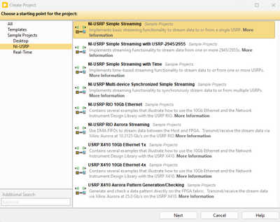

With the package installed you get a selection of example USRP projects (screenshot taken from LabVIEW 2025 Q1).
Let me know if that helped with your request!
