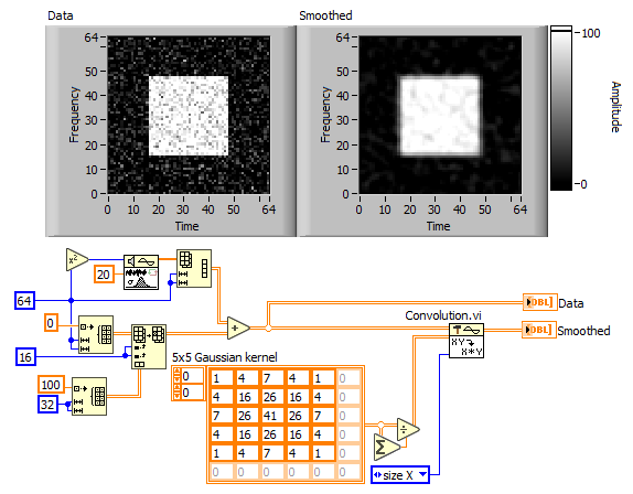

What is the datatype (U8, SGL, etc.)? The data of an intensity graph is just a 2D array, and to smooth the values all you need is to convolute it with an approriate normalized 2D kernel. LabVIEW has all the tools for that. (Use this, and set the output size to X).

On a side note, here's how you would apply a 5x5 Gaussian filter to the entire image using convolution. Of course you could do something very similar for the localized blurring by only convoluting the subset near the selected point before writing the subset back to the same place.
