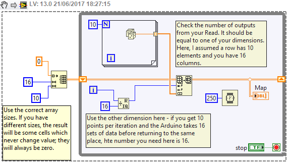

It seems likely from your description that you're overwriting the same part of the graph each loop, however, the code you uploaded makes me suspicious of either the Arduino or this 'multiplexing' you describe.
I'm attaching a snippet that shows some comments regarding the numeric constants in your VI - you can use this VI to test the effects of each constant on the output and see if it explains your problems.
If not, it might be that there's some (probably minor, but important) difficulty with your Arduino code/operation.
(4,131 Views)

So just in the top left of your image, I can see that you get 2 and 15 0s. This means you should swap all of the 16s and 10s compared with the snippet I attached 🙂
It seems definitely possible that the Arduino isn't sending all of the data that you're expecting. I'm not sure how to go about troubleshooting this - after all, it isn't an Arduino forum, and I don't know much about the code written for Arduinos, but if you upload the code I'll take a look, and perhaps I or someone else will be able to advise where you're hitting a roadblock.
