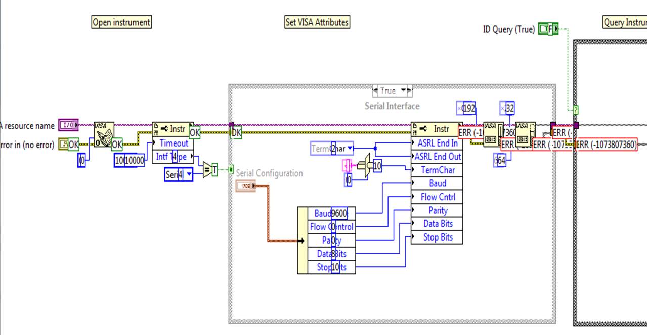

However,  one of the VIs, Initialize.vi (to open VISA session and set up the interface for communication) gives me errors about 1/3 the time I use it. What makes it hard to debug is that the errors are VERY intermittent and occur in different points in the program. I can run the Initialize.vi once, twice, maybe 3 or even 4 times in a row and NO error; then it will give me an error. Or sometimes the first time I run it I get an error. The location of the error also varies.
I have put a screenshot of one type of error below..showing error -107307360 (error at "arg5 of property node") occuring. I get this error about 1/3 of the time the program is run. Not sure how to resolve this.

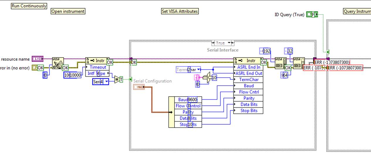

Also, in addition to this error sometimes it gets through that property node setting ok, but then i get Error -1073807300 at VISA Set I/O Buffer Size. (see error below)
Again, the weird thing is that this error doesn't happen all the time, only part of the time. Because of that I thought it was a timing issue so i woudl step through the program, but it still happened..so not sure what is going on or how I can fix it.
