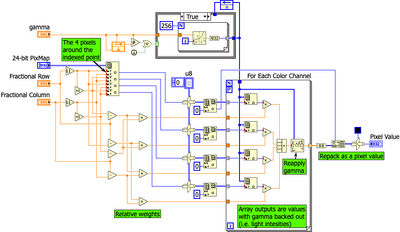

Here's where I currently stand:
I still need to figure a reasonable way to replace those multiplies with LUTs, but I'm tired and I'll think about it later
Very well, and thanks for sharing! The "good" point is that now you have a little bit more computations in your code, so it makes more sense to try to port this to a DLL and check how performance can be improved (if possible).

For reference, here's my code. Have not tested on your newest version. I am sure if could be tweaked further...
Message 37 of 95
(15,188 Views)
Thank you! Its same, but a little bit slower, probably because you have four roundings:
But the difference not significant, may be few percents 229 ms vs 242 ms on my laptop (benchmark in attachment):
