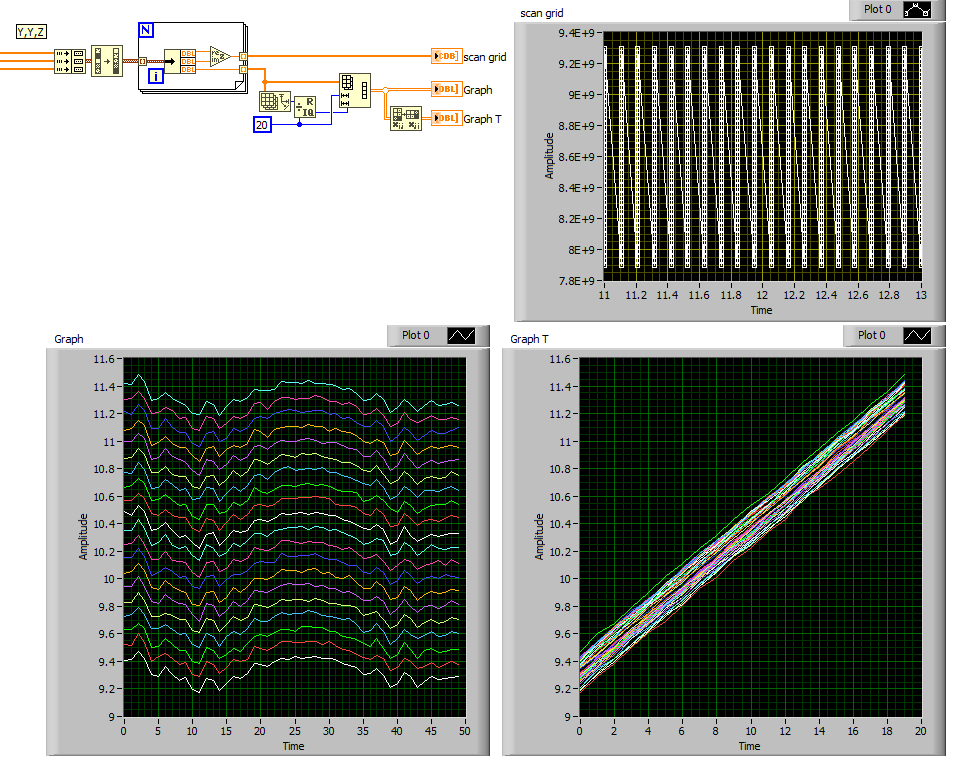

OK, first of all, you might want to take a step back and really look at the data. Once sorted in x and y, the points form a perfect rectangular grid and the data is very similar in all 50 point segments, but linearly displaced in the other dimension. This should give you sufficient information to come up with a significantly better interpolation scheme. See how far you get...
