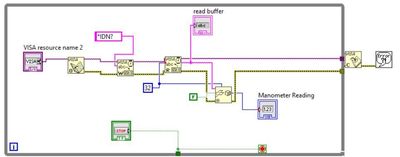

I realize I should have mentioned that the data is coming through an RS232 to USB cord. I tried all three of those options, and while it did convert it to a readable value, the value is usually somewhere around 2 billion. If I place it in a loop, the number consistently changes regardless of if I hold the data on the device, which leads me to believe that it's reading something other than the value displayed on the device's screen. Here's what I currently have. I couldn't find anything related in the manuals so that was a dead end as well. Any advice will be appreciated.

It would be more important to attach the manual of your device - or read it yourself!
But you failed in attaching a VI with some default read data from your device.
And you failed in setting the string display to \-code before making that screenshot.
Did you know we cannot debug images using LabVIEW?
So please:
- attach the manual (or provide a link!)
- attach a VI with some default data from your device!
- give the expected output for the attached default data: it is much easier to provide a conversion rule when we know the expected result from your data!
On that screenshot:
There is no example VI for LabVIEW where the port is opened and closed with each iteration of your loop. So why do you do that? (Even worse: why do you open the port with each iteration, but close it only once after the loop?)
