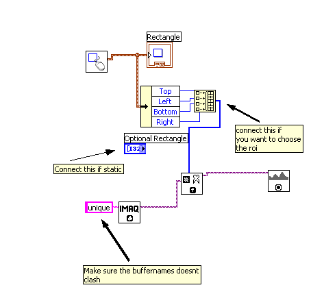

I personally feel it shouldnt be a problem to show how you are extracting a part of the image. But anyway can you tell me
1. Why you are using a roi to rectangle?
2. If i remember correctly i had suggested you to use "Imaq select rectangle". Are you using it?
3. You have mentioned you want to extract an roi which is static then why not use an imaq extract?

Message 8 of 25
(10,009 Views)

On topic: I'm sorry, I understood (big time). I thought you were talking about the type of data used when you said static/dynamic, which through me off quite majorly. I apologise... the ROIs selected are dynamic (user can select ROIs of his/her choosing).
I did try using the IMAQ Select Rectangle VI but after talking it over with my primary user, he said it would be better if he could just draw on the image display (objects of interest may move slowly while the equipment runs, so being able to make adjustments to ROI on-the-fly is useful), so that's how it currently runs. The user can draw on the image display, and I use property nodes to retrieve the ROI (always in rectangular format - I've removed the other tools). The ROI is then converted into a rectangle to allow use of the IMAQ Light Meter (Rectangle VI).
What do you mean about the "make sure buffernames doesnt clash" - I've not doing anything regarding this. Also can you say what the IMAQ VIs you're using are called?
