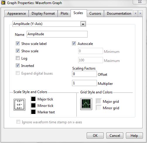

Hi, Tebefia,
There is a checkbox of invert in the scale property of the waveform graph.
Does it relate to your question?

Hi Tebefia,
- you can invert the Y scale as you already did by setting the max value as range.start and min value as range.end…
- you can use the checkmark as already told
- you can use the simple, but effective Negate function
- you could swap the wires on your DAQ AI input…
(5,127 Views)
William1225, thanks a lot for your response.  I had that your suggestion done already as I stated in my posted question.
GerdW, thanks to you too and explicit answer.  You did provide the answer to my question.  Much appreciated.
