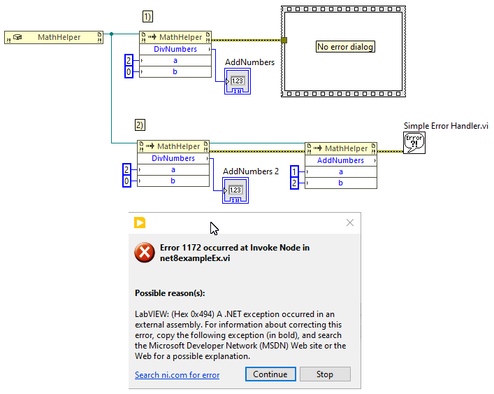

@jncuevas wrote:
The error wires are connected so I was not expecting any dialogs.
It sems tio be that the error wire is connected and propagated to the Simple Error Handler or General Error Handler. What is on the other end of the error wire?
(1,430 Views)
Thank you for the reply.  After closer examination I did find simpler error handler wired downstream from the error.
