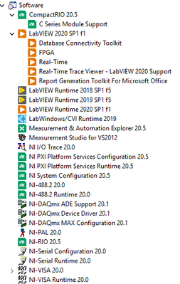

I have tried reinstalling Windows from scratch and installing LabVIEW all over again but got the same result.  I have tried comparing the list of items installed with Package Manager on the two computers and they are identical.  I have included the list of what is installed below for reference.

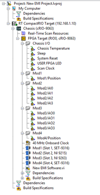

I am using a cRIO-9063 as my Target with an SET module in Slot 1 and 4 (see project below).
Yes I can compile FPGA code when there are no SET modules in the project and no SET module calls in the code.  However once there is even one of the SET modules in the project I cannot compile even simple FPGA code that doesn't use the SET modules.  (I have tried just a VI with a loop set to false and an indicator on the loop counter and it fails to compile if there is a SET module in the project).
As I mentioned before though, I have a work computer running Windows 11 (corporate managed) and I installed all the same versions of LV and the SET drivers and I can compile my FPGA code without any issues.  I have a personal laptop running Windows 11, and I installed all the same versions of everything on it and I can compile my FPGA code without any issues.  I have this brand new Dell laptop with Windows 11 and I install all the same versions of everything and I cannot get my FPGA code to compile.  I have tried reinstalling Windows and reinstalling LV & drivers again and get the same result.  I am starting to think that there is something default in this new Win 11 that is blocking access to a folder, app, etc. that is causing this issue maybe.  If that is the case, then I am hoping that someone else has come across this issue and maybe a solution.
Here is a picture of my project that is on all three computers (work pc - working, personal pc - working, new laptop - error).
(901 Views)
